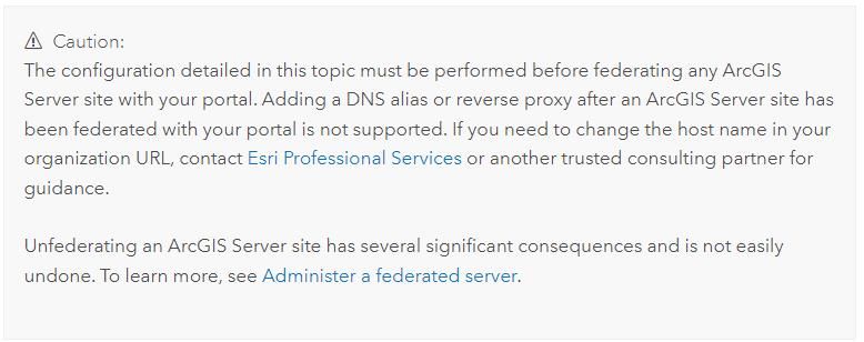

If looking to update the privatePortalURL for an existing environment that can be done following steps 8 and 9 in this documentation topic. The value that Portal for ArcGIS uses will take precedence over anything set in the federated ArcGIS Server sites' security configurations and be overwritten each time federation is validated.
