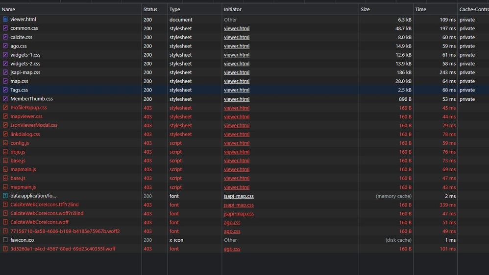

MarcBate
Here is the list of requests from the viewer.html. When clicking on any of the 403 resources, they appear a new browser tab so they can be accessed. I'm not sure what headers can be added and to which IIS (DMZ or internal).viewer.JPG
