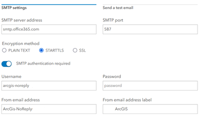

I integrated it in the exact way you mention, but with a different port, could you try this out here:
I think 587 is the desired port to use now.

Hey @__JackCharde__
Ah alright I see, definitely appears that SMTP is disabled on the administration side of the Office 365 environment you're in. The link in the error will guide your IT in enabling the SMTP client for the specific email account that you'd need. Once that's enabled, then the port should allow for the traffic to come through, ours was not enabled by default so we didn't run into that exact issue.
