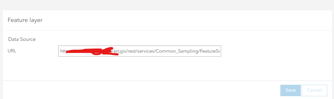

We recently upgraded from Enterprise 10.9 to Enterprise 11.1.  As part of the process, we created new map services in ArcGIS Pro to replace the old ones from ArcMap. Once we created the new services, we updated the service URL for each web map layer (the wrong way!). We opened the web map overview in Portal, clicked on the layer, and then updated the URL at the bottom of the Settings tab (screenshot included).

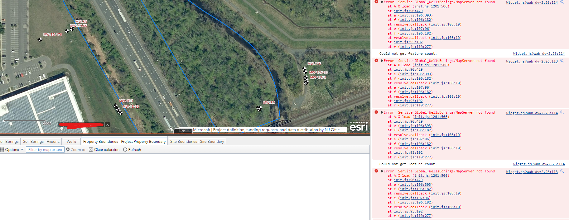

We just found that for the web apps where we followed this process, the attribute table widget is still pointing to the original service URL (using Console in the browser)! I cannot find any place where I can update this reference within portal. The items in the web map all point to the correct service URL. The Filter widget still works as expected, so it appears to only be a problem with the attribute table widget.

Example of where we updated the URL originally:
Screenshot of the console error:
