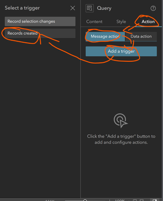

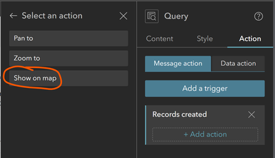

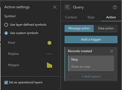

I was able to get this to work, but the option to specify the symbology of the query results is on a different page.
Go to your query widget and click Action > Message action > Add a trigger > Records created > Map > Show on map. Then you can specify the symbology you are wanting for the results of your query. I attached some screenshots as well.

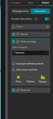

This is sort of a continuation of this thread, so I'm hoping to get an answer. When I run a query on the two layers within my app, I get different responses in the results. In both cases I've set up so that the results show results using the webmap settings, which results in a filmstrip with a thumbnail image and some text. If I click inside any example of one of my point feature results, the map zooms to that location. However, if I try to do the same for the polygon features nothing happens. I can't use the 'Data Actions' option, which might allow this, because it enables Export of data (even when this is unticked ☹️) and I cannot allow this.
