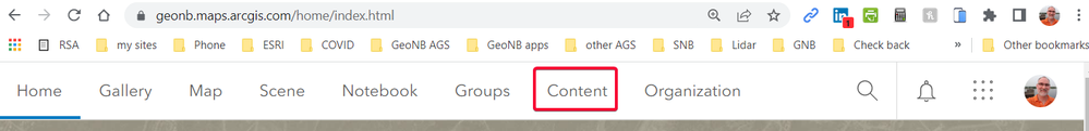

Sounds like you must have been given an evaluation account on ArcGIS Online.  When you first login to arcgis.com you should see a header like this:
It was previously called "My Content" but now its just called "Content".

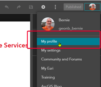

If you are already in the ExB app you can click on your user logo in the top right corner and select "My Proflie" from the drop down menu.  This will open a new tab and display the "Content" link in the banner across the top of the new tab:
