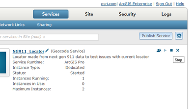

It may depend on the kind of service it is, but generally you can do that from ArcGIS Server Manager, typically found at your-org-url/server/manager
- Josh Carlson
Kendall County GIS
Yanlin_Li
You can also stop services on ArcGIS Server Administrator Directory page
"FQDN/ name of your web adaptor/admin"
Choose the services you want, and click on them, and scroll down "stop"

Hello Jose, apologized for the late reply, you can request a login from the administrator for ArcGIS Server Manager, https://enterprise.arcgis.com/en/server/latest/administer/linux/managing-users-in-manager.htm
You can just delete and republish the feature layer, as a workaround.
