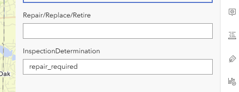

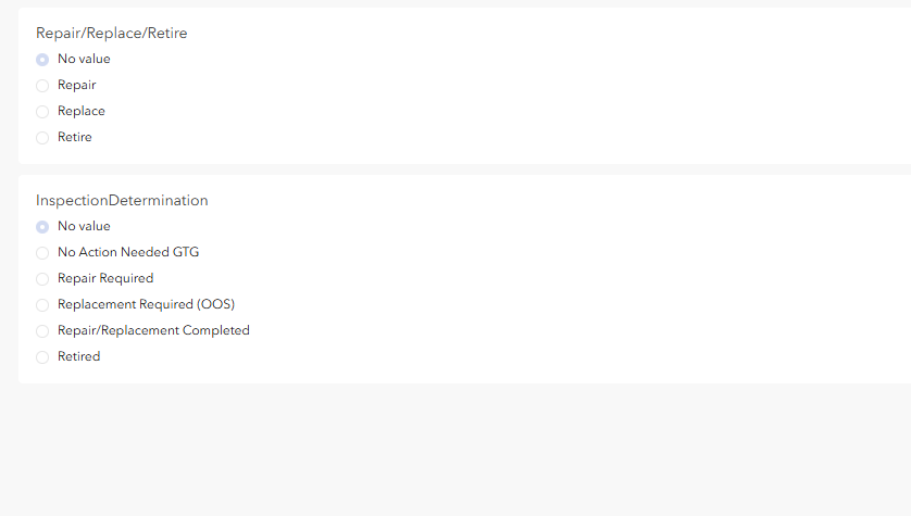

I have Enterprise 11.5. I am working on a simple map that could be used either within Field Maps or Instant App. I have two fields that have domains within for choices. I configured a simple form using the Configure Editing > Forms. In the Forms window, everything looks as it should and Field Maps looks good as well.
My issue is within Instant App or just Editing within MapViewer. When I edit the feature, the popup form just shows a blank box or whatever the existing data shows. It does not show any choice box or drop down. I can only type in data.
I get that forms are generally used within Field Maps.  Is this by design or am I missing something? This happens for both hosted and EGDB referenced data.

something doesn't seem right. The form in Map Viewer should display the radio buttons, just like you see in the Form builder. I recommend submitting a ticket so we can help troubleshoot.
