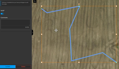

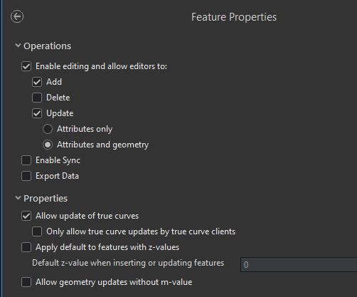

My organization recently upgraded to ArcGIS Enterprise 11.3 from 11.2 and I am experiencing some issues with editing features within Map Viewer and Experience Builder that were not present before the upgrade. I have a feature service that is referencing registered data from a SQL Server enterprise geodatabase. The feature service is enabled for editing and users are allowed to add and update features, but not delete them.

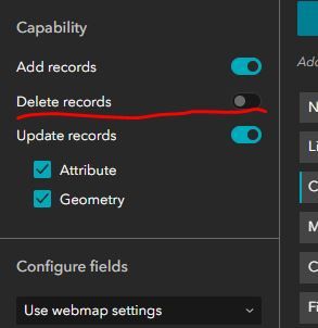

Additionally, in the edit widget settings for the Experience, the delete features is disabled (and can't be toggled on).

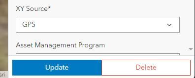

But the form still allows the user to delete features. I also tested this with other users that are not admins and they are able to delete features as well.

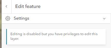

Additionally, this warning appears at the top of the form in the Experience: "Editing is disabled but you have privileges to edit this layer". This warning appears for the other users I asked to test this as well.

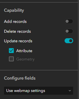

Same. Extremely disappointing as we are needing to migrate our WABs and Experience Builder is still this bad.
The settings for my feature are set to allow attribute updates only. Yet, somehow, ExB still allows users to create new, update geometry, AND delete features. (11.3 - SQL non-hosted feature service)

I was able to work with Esri Support to get this resolved. We had a custom member role that had Updates allowed under Administrative Privileges. Toggling this off fixed the problem. (Note: Members with the Administrator Role can still edit all hosted layers (and referenced layers, it appears), regardless of whether those layers were shared as editable feature services.)
