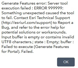

I also have a new issue with the "Add Data widget." It cannot read any data, including KML files generated by the "Analysis - Extract Data" widget. I consistently receive errors (see my attached files) or a message stating that the format is not supported, even for KML files generated by the Extract Data widget.
P.S. Issue with "Add data" widghet is stabil as before patch instalation, as after.
