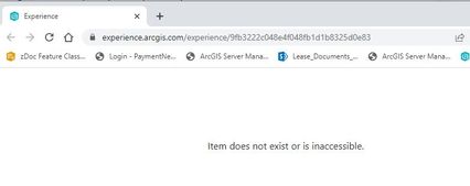

We've noticed that any Experience Builder app, when added to the Gallery, will not open:
But we can still open the app from its description page, or from any "content" view. The url of the app is:
https://internal.moagis.com/portal/apps/experiencebuilder/experience/?id=9fb3222c048e4f048fb1d1b8325...
Notice the difference in this url from the one in the gallery...seems the gallery app modified it to a form that doesn't work?
so wondering the gallery instant app has a bug in it for experience builder app?

Just a follow up..... this is a logged bug in Enterprise 11.1

Hi! Out of curiosity, are you still experiencing this?  The Bug report is not listed as solved yet
Amarz
I am experiencing this in Enterprise 11.2 still
CassidyKillian
Just came across your post as I am doing some digging on the same issue at 10.9.1.  I have a call with support this morning so I will definitely mention this bug and see if I can help get is escalated.
CassidyKillian
I had this bug added to my support case last week and escalated.  I just received notice that this bug has been fixed at version 11.3.
