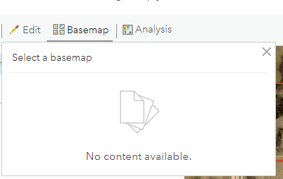

Hello,
I created a web map using our own basemap in portal. Currently we are in ArcGIS enterprise 10.7.1. Maps were created more than a year ago and now when I try to add ESRI base map, they are missing from the basemap gallery.
Has anybody ever faced a similar problem and was able to solve it?
Thanks in advance for your time and suggestion.

berniejconnors
We have experienced a similar problem with the Basemap Gallery widget in our Web AppBuilder apps.  The cure was to clear web browser cache.  But first you can test it by opening the webmap in an Incognito window.  If the basemaps appear you can proceed with clearing your web browser's cache - <Ctrl><Shift><Del> should open the clear browser cache window.

SunitaKhanal
Thanks for the suggestion. Unfortunately, it did not work. I tried in a different browser and also in the incognito window but no luck.

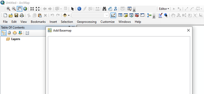

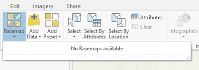

SunitaKhanal
Agree. Just found out that I don't have basemaps available in ArcMap as well as in ArcGIS pro.
