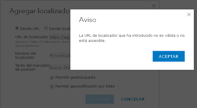

I've come across an error while attempting to add a geocode locator in Portal for ArcGIS 10.6.
I want to use the geocoding locator utility service available on a federated ArcGIS Server 10.6
Followed the instructions in the documentation http://enterprise.arcgis.com/en/portal/latest/administer/windows/configure-services.htm#ESRI_SECTION...
but when pasting the URL copied from the service overview page in Add Locator in Edit Settings, error messega indicates the URL is invalid. See screenshot below.  The geocoding service is started and shared with the organization.

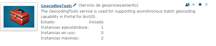

The GeocodingTools is the geoprocessing service that runs in the background and supports the ability to batch geocode. It is not the actual geode service or locator service that is used to match addresses during geocoding.

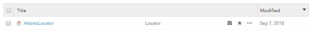

2. When you add the item to portal, does it show as a 'Locator' item?

1. .../rest/services/Utilities/GeocodingTools/GPServer
2. It shows as "Geoprocessing Service"
3. Correct

The issue is because you are trying to add a Geoprocessing Service as your Geocoding Utility Service. You can only add a Locator Service (Geocode Service) as a Geocoding Utility Service in Portal.
The URL would follow the format (key is that it will end in /GeometryServer):
https://<webadaptorhost>.<domain>.com/<webadaptorname>/rest/services/<servicename>/GeometryServer

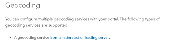

Just wanted to say that the reason I was trying to add it as a service is due to the esri documentation.
So my question is, how can the Geocoding operation be enabled on that service ?
