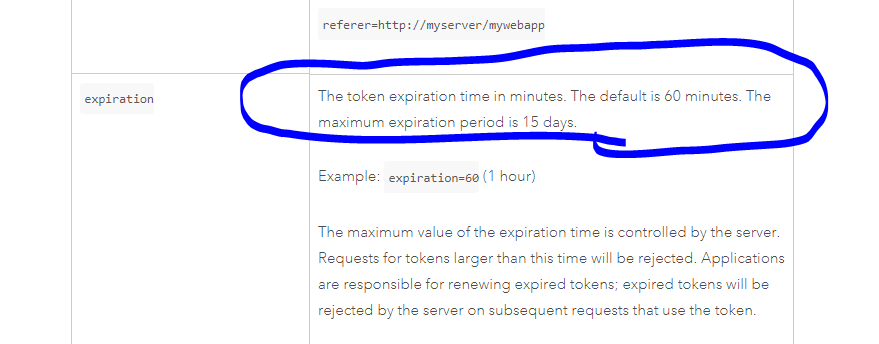

According to the Rest API the the maximum length is 15 days
Generate Token—ArcGIS REST API: Users, groups, and content | ArcGIS for Developers
