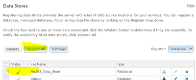

The actual answer to your question is, there is no expiration date on DataStore, it's on Server. If you let Server expire you might have to run the "updatelicense.bat" to reconnect.
I had a broken DataStore a few months ago, Esri had me re-install it and there is no license process. You install it and then you go into Server Manager -> Sites -> Data Stores and "re-connect" it in there. You can delete or add a single DataStore.
Reading the docs, it looks like updatelicense.bat is doing the same thing -- it's checking your Server is available and then creating an entry referencing it in the DataStore.
You can do a "validate" in that same place on Server Manager to make sure the Data Store is reachable,
It looks like this
