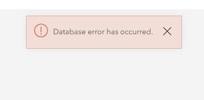

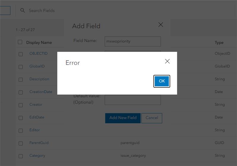

Hello I have gotten in a sticky situation with one of my feature layer's on my clients portal. It has thrown me the error 'database error has occured' will not let me update fields in any manner (add, delete, change), also will not let me change my settings. when I tried to add a field it gave the 'Error' message below and when I tried to delete it gave a 'data error' message which is why I did the overwrite talked about below.
I completed an overwrite through pro, to client's enterprise portal 11.1 and it would add my fields I needed no issues, but tried to change my editor tracking settings through the settings when I overwrote the layer and wouldn't take those setting changes.
No issues on Monday, issues started on tuesday and it is wednesday and still giving issues.
We completed an start stop on the server side of things, no changes still can update fields on the actual portal side nor change the track changes settings.

Hi Jake, sorry went away on vacation, but I was actually able to fix it by just turning off the editing settings and turning them back on!
