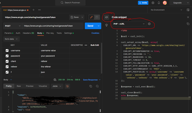

PanagiotisPapadopoulos
you may try the request into  Postman and then you can produse the required code
