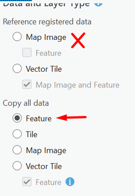

I make a fundamental mistake. The most important thing is TO PUBLISH THE MAP SERVICE AS FEATURE SERVICE (you know, the map service that can be edited online..). Never know about this...
First of all, on ArcGIS Pro, choose "Copy all data: Feature" when sharing / publish the map.  Here is the option to publish as Feature Service :

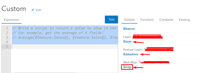

After this, then you will see some options on the Attribute Expression when you create Web App (the Classic one). These options did not appear before... See picture below:
I read on another post regarding the same problem in this Community Forum (can't find it.. some guy named "xxamrstrong) that you have to publish it as individual map (feature) service too, to be able to activate the calling to the Identifier...
