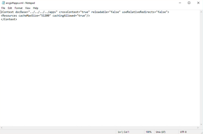

I followed up with our local ESRI support after seeing the fix at 12. They mentioned that a software patch named Portal for ArcGIS 11.5 Web Applications Patch will be released soon to resolve this defect.
With preliminary fix the change to the XML, we made a backup of the file in another location and replaced the contents as per the attached screen shot. We've been told that we need to back out this change when the Portal for ArcGIS 11.5 Web Applications Patch is rolled out.
I'd prefer ESRI support to provide the information given the potential risk of the preliminary fix and the impact the issue had in our environment. Therefore, elaborating without any warranty or liability.
Therefore, I'd strongly suggest that any changes are run past local ESRI support first, and if implemented in anyway, done so in a non-production environment first with thorough regression testing.
