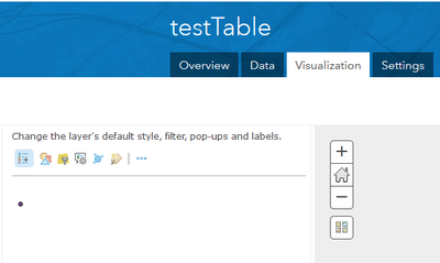

Thanks. Are you doing this within a web map? I'm looking to configure the service without creating a web map. Or maybe it's cuz I'm in 10.6 - I don't see an option to do it on the feature layer

No, I understood you - I see it's possible to do within a web map. I'd like to do it without a web map (e.g. in the Visualization settings for the feature layer like you can for non-table layers). Thought maybe you could do it in the JSON for the service. But it doesn't sound like either of those is possible

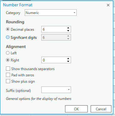

If you use Pro in the Design >  Fields dialog you can designate whether or not the thousands separator is showing for a numeric field
