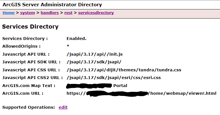

My organization have deployed a Federated ArcGIS Portal which uses Windows authentication. I manage several federated ArcGIS Servers in the same domain and are accessible in the same way. My network does not allow using the defaulted http://www.arcgis.com portal for previewing services since we secured the servers per guidance. I made the necessary changes to point the Services Directory's ArcGIS.com URL setting to my organization's portal as below:
Admin settingsSvc Dir

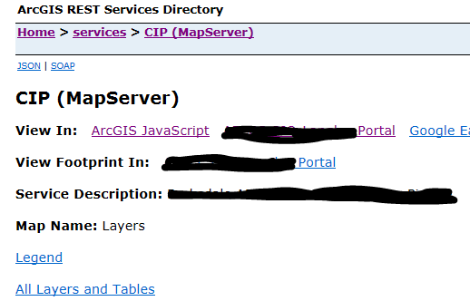

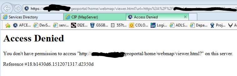

Unfortunately, when I click on "View In: [Organization] Portal", I get the screen below:
SvcDir
The first thing that strikes me is that it calls it as HTTP, not HTTPS, which is weird since that's not how it was configured. It might explain the access denied, because it's not allowed on network, but that's not reflected on the browser's address bar.
  1. Is there something that needs to be done for the portal to allow its usage on my ArcGIS Server? I assumed that wouldn't be the case if it works in same way as the default arcgis.com site.
  2. Why does the error shows up as an unsecured/http address?
  3. What does the error message means by "on this server"?

On the same machine, are you able to manually navigate to the Portal Map Viewer? The error is definitely strange as the address bar clearly uses https.  The error doesn't appear to be a Portal error, what is in front of your Portal?  A reverse proxy or are you using the web adaptor? I assume the WA as you mentioned Windows Authentication.
If you were to go to the Portal Map Viewer and just append a ? at the end, what happens?  To be honest, I'm not really sure if it'll redirect or anything, just interested if there's something blocking certain requests.

Nothing different seems to happen when I browse to "https://<server-portal>/geoportal/home/webmap/viewer.html?", stays right on the page.
portal
I get the same error when manually complete the parameters "?url="<mapserver>&sourceid=sd on the address bar.

No, I think that error is thrown by something in front of your Portal, like a reverse proxy or less likely, IIS. The error page isn't a normal one you would see either in Server, Portal, or IIS.  I would talk to whoever has knowledge on the configuration of the environment to track down the problem.  If you know the mahcine name running Portal, you can also bypass the front-end of it and reach Portal directly:
https://portal.machine.com:7443/arcgis/home/webmap/viewer.html?url=<serviceurl>&sourceid=sd
If it works directly through 7443, then that would confirm it's a problem with whatever is in front of the Portal.
