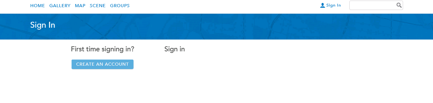

i'm trying to configure ArcGIS for portal with ArcGIS web adaptor but i've two issues .
The first one is  my machine is a workgroup machine , and when i try to configure the Web Adaptor, it requires to specify the URL and an administrator account for my Portal, but always i get an error that Portal configuration requires fully qualified domain name in the Portal URL like the image below ..
Second one is i've created the initial administrator account for ArcGIS portal but when i try to sign in it always redirect me to same page , and seems that i'm not signed in , like the following image shows ..Untitled.png
any help pleaseeee ???

Hi Ghofran,
The first problem is not the Portal issue, but rather the system.
You have two options:
1. If this portal is only for testing, you may add FQDN to the hosts file like in the following string:
10.1.1.5     portal.domain.com
and then distribute this file to all machines taking part in your test.
2. If the portal will be accessed from the large number of clients, ask your IT to add your machine to domain zone in your DNS.
You may also need to add domain suffix to the IP configuration on your portal machine.
Anyway, it would be a good idea to consult with your IT manager.
When you will configure the Web Adapter, think the second problem also will gone.
Regards,
Gennady
VaL
Hi all,
I have the second problem with the signing in with the initial account. I see the same picture as the op above.
My firewall is off. Web adapter is configured OK.
What is the problem?
