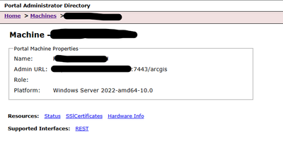

Hello,
we need to change the server of our ArcGIS Enterprise 11.3 single machine deployment because the Windows Server installation is corrupt.
I have created a backup with WebGIS DR and successfully deployed it to the new server.
However, I noticed that the Admin URLs of Portal, as well as ArcGIS Server and DataStore have changed. Before, they were pointing to SERVERNAME:6443 / :7443 / :2443. After applying the backup the servername has been replaced by the public facing URL (Web Context Url).
The public facing URL does not support the use of ports like :6443, so the new deployment is not working. I was able to edit the values for ArcGIS Server and Datastore but I have found no way to change the Admin URL for Portal (see attachment).
Is there a way to change this in ArcGIS Enterprise 11.3 or anything else I can do when creating the WebGIS DR backup?

Martin1
Hi @GlenterpriseUK
Thanks for answering. I changed the "admin url" of Server and Data Store to the new machine name in the Portal and Server Administrator Directories. It seems to be an accepted workflow.
However, it is hard to tell if everything works perfectly.
What made the whole system come back to life, was editing the hosts-file on the server, and let the web context URL on the server point back to the IP of the server. Like that the ports are reachable. However, I doubt that this is a suggested, sustainable workflow.
