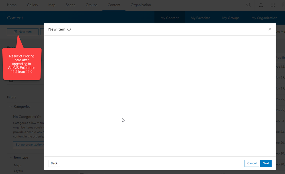

I just upgraded my portal from 11.0 to 11.2.  Everything seems to be working for the most part but when I attempt to open an existing map in my portal's content, it will only open in the Map Viewer Classic and will not open in the "Map Viewer".  I also noticed that I can no longer "Add New" in the portals content section, just a blank window opens.  I'm wondering if these are related?
New item screen is blankNew item screen is blank

I had to set a web context URL in portaladmin that pointed to my custom dns entry for portal. This fixed the Map Viewer issue.  I learned this at DevSummit.
