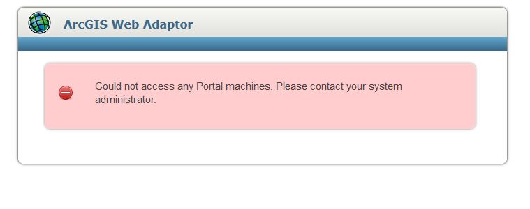

Hi I get the following error after upgrading to portal 10.4.1
I can access the portal with https://domain:7443/arcgis/home, as soon as i remove the port i get the above error
I can access the portaladmin account via URL
I can access arcgis server manager and rest end points via URL
Any ideas

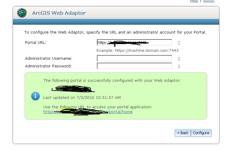

I hope the Web-Adaptor is of the same version (10.4.1).
Update the SSL certificate in IIS once again. Reconfigure Portal for ArcGIS with Web-adaptor.
Think Location
HendrikBritz
The web adaptor is of the same version
Updated the SSL and reconfigured portal, still the same

3. The Portal web adaptor looks correct above but it seems that something is off.
   I would try uninstalling it and reinstalling.
If that fails, I would probably uninstall both AGS and Portal Web Adaptors and try reinstalling.
Did try this
Did try this

Hi All
Thank you for all the help. I finally uninstalled portal, deleted all the parent folders and cleaned the registry. Re installed portal and everything is working now
