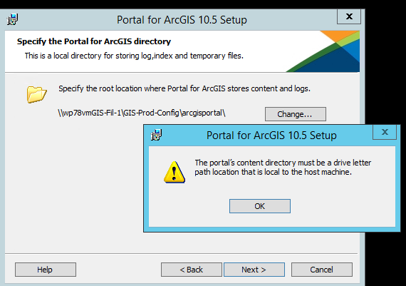

When I set the content directory of ArcGIS Portal to be highly available I get a message that the portal's content directory must be a drive letter path location this is local to the host machine.    See attached doc.
.Portal Content Directory Must be a Drive Letter
Everything is shared
I can see the directory
I have access to it.
Tried to map a drive letter on the machine to the share with same results.
What is going on?
Thanks.

By default, you'll need to create the content directory locally, but you can change it after the install process. Some directories MUST remain local, but others can be moved. See:

When initially installing Portal, you'll set the default content directory to the local machine.  This is where the template content, index, and other files will be stored.  Once Portal is installed and you reach the Portal home page, you can define where you want the content to be stored at.  It's at this point you'll set the content directory to a shared location.  I'll look at the doc to see if we can make that more clear.

When setting up a highly available Portal, the high level process is:
1) Install the software on the first portal machine
  • During the installation process, you have the option of specifying a local drive for the default content directory. This is where internal files and data lives, (aside from content). This can also be where you define the content directory when creating the portal, but adds an extra step
2) Create the portal site on the first machine
  • You can choose to create the portal site and specify the content directory to be set to the share you've defined previously, or a local path. If you choose to create the portal with content on a local drive, you'll need to move it:
               Changing the portal content directory—Portal for ArcGIS (10.7 and 10.7.1) | ArcGIS Enterprise
               If this is a new deployment, it's easier to create the portal with content on the share
3) Install the software on the second portal machine
  • During the installation process, define the same drive and path that you used to install the first portal
  • Ensure that the account used to install the software on the second machine can access the share storing the content.
4) Join the second machine to the first
I think we can update the documentation for installing/configuring the first portal to not link to the documentation about creating a standalone portal and just indicate to use the share on your file server.
