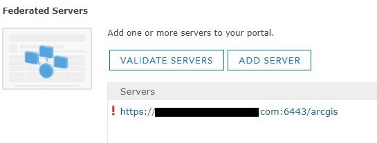

https://portalurl:7443/arcgis/sharing/rest/portals/self/servers, registered the new server, and unregistered the old server. Restarted the Portal and all looked good in the Portal settings too. The old servername was gone and the new one appeared:

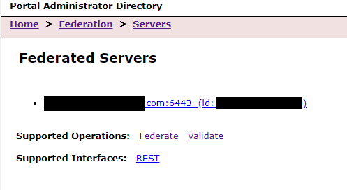

Same in the Portal Admin Dir:

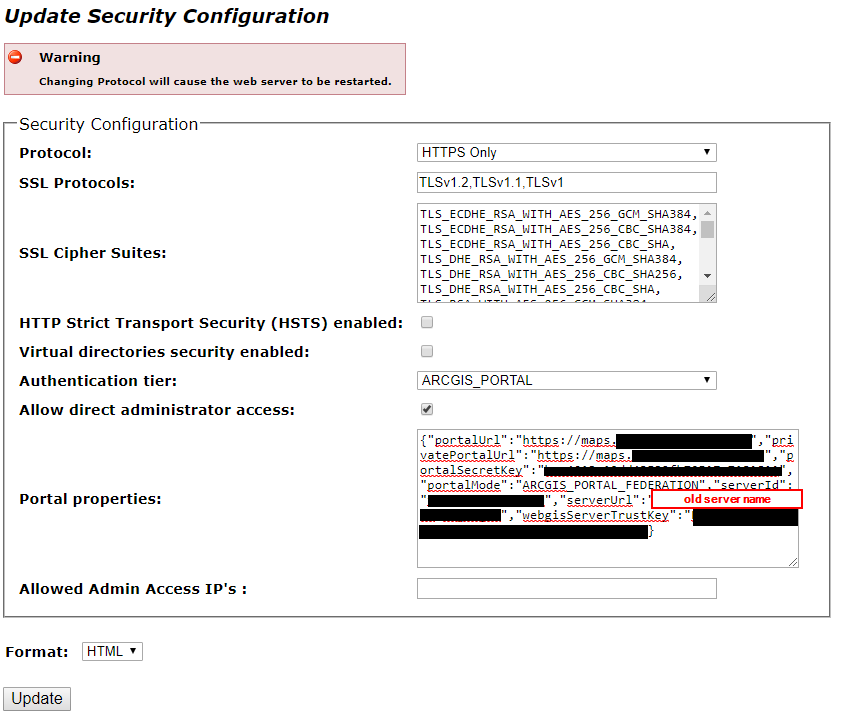

Would it be safe to change the Portal properties under this link: https://serverurl:6443/arcgis/admin/security/config/update
Where do I find the PortalSecretKey and the webgisServerTrustKey in that case?
