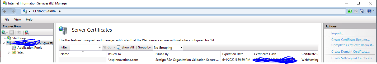

I am connecting to a Portal with ArcGIS Pro and am receiving the alert below.  I am able to access Portal with the cert appearing as valid and the site is trusted.  I have added the intermediate, root, and private key certs to portaladmin.  The only thing that seems to be a bit different than previous configs is that the certificate store is in WebHosting versus personal.  Does this matter?  How do I resolve the security alert in Pro with my portal URL.  I am using a wildcard cert.  This an ArcGIS Enterprise 10.8.1 Base Deployment as well.

ArcGIS Pro is likely complaining about the certificate used for the Admin URL of the deployment. If you looked at the certificate, (clicking on the View Certificate button), is the CN the wildcard, or the FQDN of the machine? If it's the FQDN of the machine, you can do two things:

The CN is the wildcard.  Do you know how I can resolve it with this being the case?
