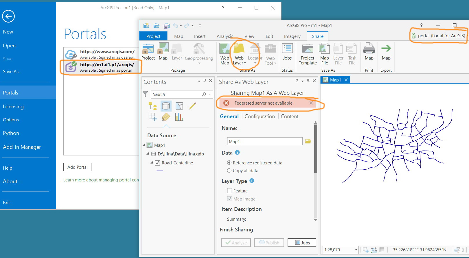

ArcGIS Pro fails to publish in Portal and ends up with “federated server is not available” error,
Despite the fact that the Portal and Adaptor are successfully installed and the portal is added to Pro, signed in and set as active, Pro fails to publish data using the “web layer” tool and ends up with the “federated server is not available”.

Hi Jamal,
The short answer is that you cannot publish to a standalone Portal for ArcGIS. You will need to have all components of the ArcGIS Enterprise installed and configured before you are able to publish hosted feature services to Portal for ArcGIS.
ArcGIS Enterprise is comprised of four software components: Portal for ArcGIS, ArcGIS Server, ArcGIS Data Store and two installations of ArcGIS Web Adaptor, one for traffic to your ArcGIS Enterprise portal and another for traffic to your hosting server.

Hi Jamal,
You need to make server federation if you want to publish service into Portal for ArcGIS.
Portal for ArcGIS is not a server, it is an environment that contain your services.
I think here there is no any added value if ArcGIS server and ArcMap achieve your work.
Please note that ArcGIS pro and portal for ArcGIS will help you if you want to publish 3D web scenes.
