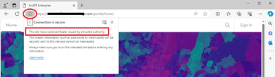

Hello @AbdelrahmanGhazaly , does your browser's URL bar show a valid certificate ? Certificates can expire silently and cause unexpected problems.

I faced the same issues too. The map tab doesn't exist, and I can't reach any organization data.
my certificate hasn't expired yet
