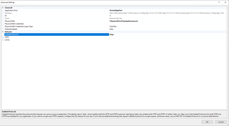

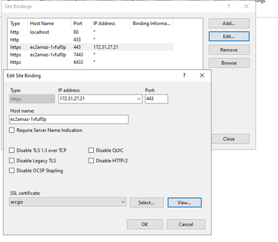

I didn't found information about IIS 10. The documentation present the following "add site binding window" that doesn't exist in IIS 10, where I have the following options:
Do you have any idea?
Thank you
Giuseppe
10 Replies
AyanPalit
@gpgisandsky The screenshot from IIS 10 suggests you are in the right place.
Set site binding as follows:
Type: https
Port: 443
SSL certificate: Choose the SSL certificate with the server host name. This option will show when Type is changes to https.
Good luck!

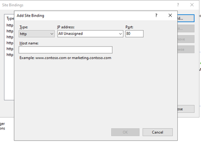

thank you for your reply. I can't change http to https because how you can see in the above image http is grey and I cann't change it. I don't know why. In advanced site setting I tried to change "enable protocols" from http to https but nothing change in "Add site binding window".
Do you have any other suggestion?
Thank you
Giuseppe P.
AyanPalit

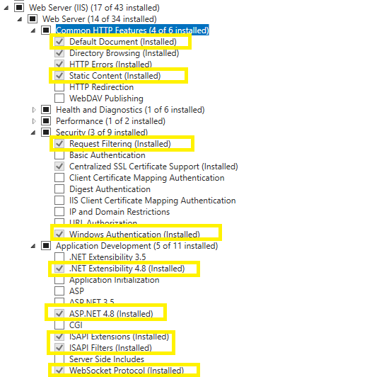

Perhaps you are missing required IIS components - Consult your IT system admin knowledgeable in IIS webserver.
Review and validate: https://enterprise.arcgis.com/en/web-adaptor/latest/install/iis/manually-enable-iis-and-required-com...

all required IIS components has been installed on server.

Hi Ayan,
my previous consideration about site binding was wrong. I'm able to change http to https if press "add..."  instead of "edit..." existent site so I removed previous site and I added https/443 with a SSL certificate. The SSL certificate has been created with "created Self-signed certificate" tools of IIS.

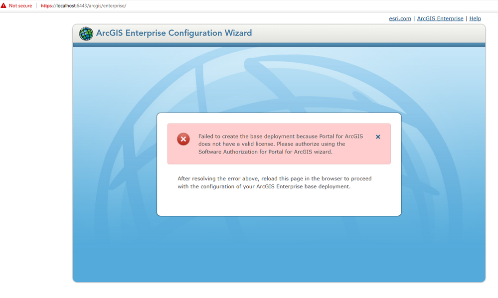

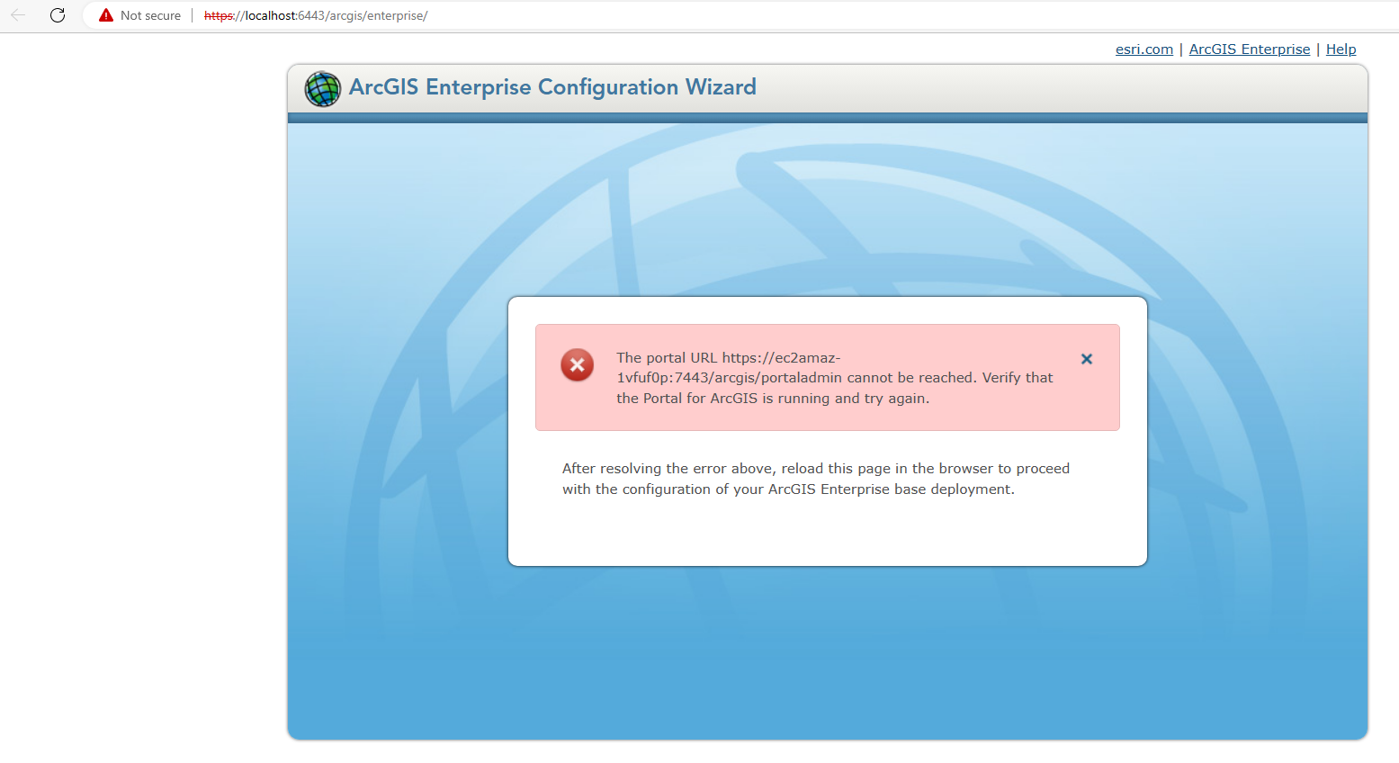

After that a new error messagge appear:
During the  ArcGIS Enterprise Builder installation I provided a valid arcgisenterpriseportallicencexxxx.json e arcgisserverlicencexxx.prvc licences.

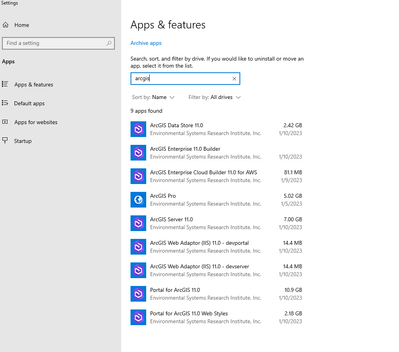

I tried to reinstall "Portal for ArcGIS" using "repair" option but the above message persist. Within my window Esri app there isn't "Software Autorization for Portal for ArcGIS" link but only  "Software Autorization for ArcGIS Server" link. On my server I have the following arcgis software:
Do you have any other idea?
Thank you
Giuseppe P.
AyanPalit
The https/443 with SSL certificate is a pre-requisite to installing Enterprise Builder. Now that you have added it correctly, suggest uninstall completely, reboot the machine and re-install.  This will be the cleanest way.
If uninstall is not an option, you will have to troubleshot step by step. The Portal is licensed during create a portal  step.

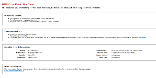

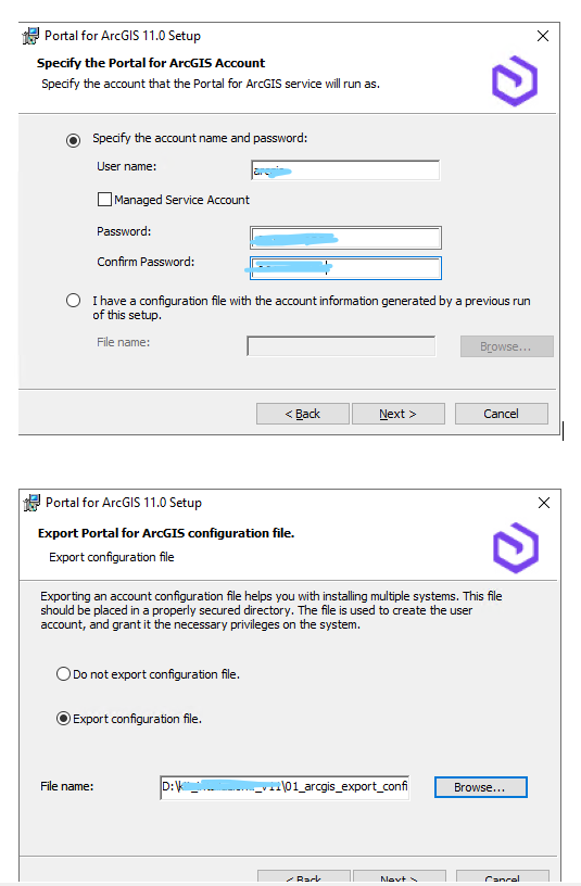

thank you for your reply. I've a EC2 instance (t2.xlarge with 4 vCPU) on AWS. Today I 've unistalled all Esri components and deleted all old directories. Now I installed Portal for ArcGIS (Portal_for_ArcGIS_Windows_110_182885.exe) only where i provided the following information during the installation steps.
Also I used D:\arcgisportal like home directory instead of C:\arcgisportal
The installation has been completed without error but opening web browser at https://ec2amaz-1vfuf0p:7443/arcgis/home or http
I got the following error:
Looking in physical path c:\intetpub\wwwroot the folder arcgis\home  doesn't exist and in IIS there isn't virtual directory.
The log file (see xyz.log) contain the following verbose message:
The process monitor did not find the connection to the configuration store. The site may not have been initialized. After the site is initialized, the check for database processes will be reattempted.
Do you have any idea? It's a just the new first step....
