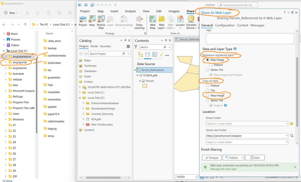

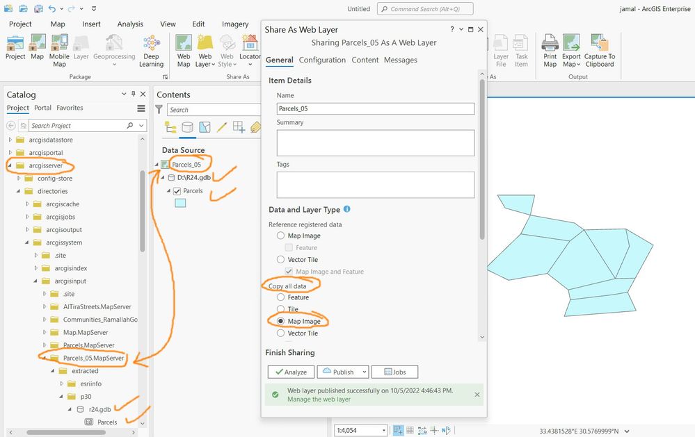

Even When publishing with “map image” option under the “copy all data section”, the physical data is saved in “arcgisserver” folder (as per the screenshot below) but not in “arcgisdatastore”.
What could be the issue here?

Only data for Hosted layers will be saved in the "arcgisdatastore" folder. Map Image layers are not Hosted, so the data for them is saved within the "arcgisserver" folder.

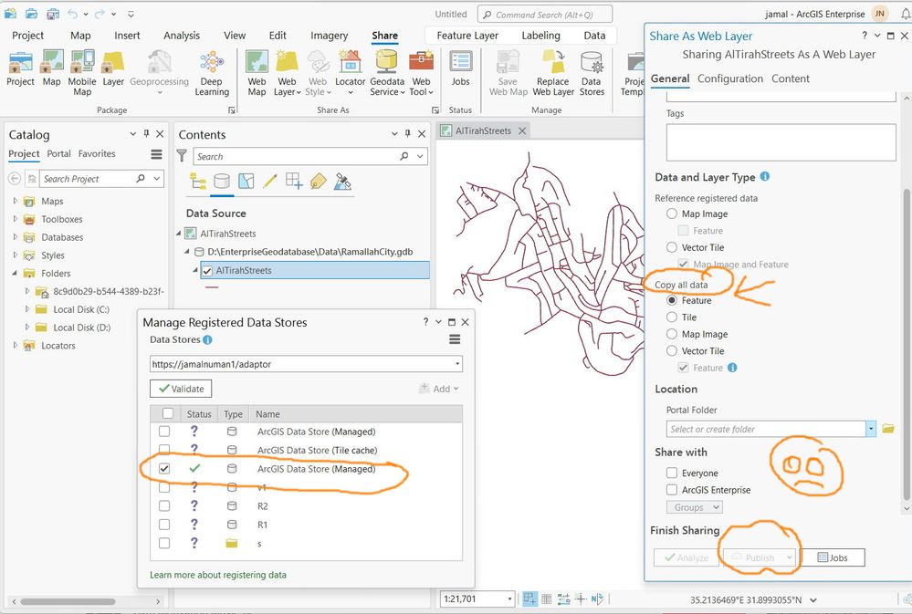

JamalNUMAN
Legendary Contributor
Under the “copy all data” section, as the feature is selected, the “publish” button gets grayed out.
