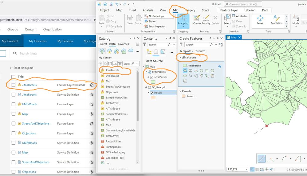

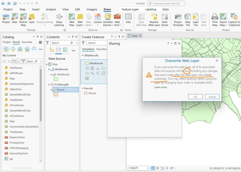

JamalNUMAN
Legendary Contributor
As per the screenshot below, it appears that there is kind of connection that's kept between the “hosted feature layer” and its source data. For example, if a field is required to be added to one of the class features of the source data that particiaptes in the service, then schema lock error pops up.
What I meant here that we need the users of our services to enjoy the advantages of publishing our data with “feature layer” format but unfortunately, we are losing one major functionality: edits are not synchronized! This means that we need to publish the same data twice: one as “map image” (feature enabled, of course the data needs to be enterprise), and the second as “feature layer”

RyanUthoff
MVP Regular Contributor
You can take advantage of synchronized edits if you use a traditional feature service. A hosted feature service will never be synchronized with your local copy of data because you are physically copying the data to the server.
Again, do not use a hosted feature service. Use a traditional feature service with a DB that is registered with the ArcGIS Server pulling from an enterprise geodatabase. If you do it that way, your edits will be synchronized.
The schema error you are receiving doesn't have anything to do with the hosted feature service. You or someone else must be locking you out. You have to close all connections in order to add a field.
