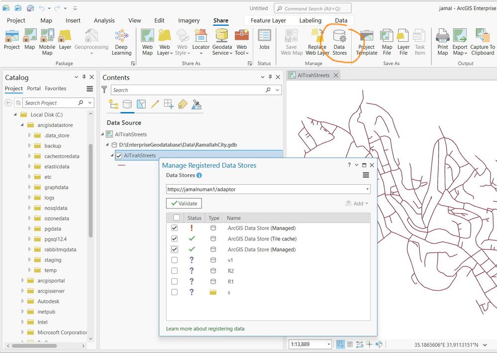

MariaThors
I have the same problem, but the checkmark is grayed out. Status says "Not Available". The database does not exist any longer, I need to unregister the connection...
MariaThors
Found out how to do it, from Pro.

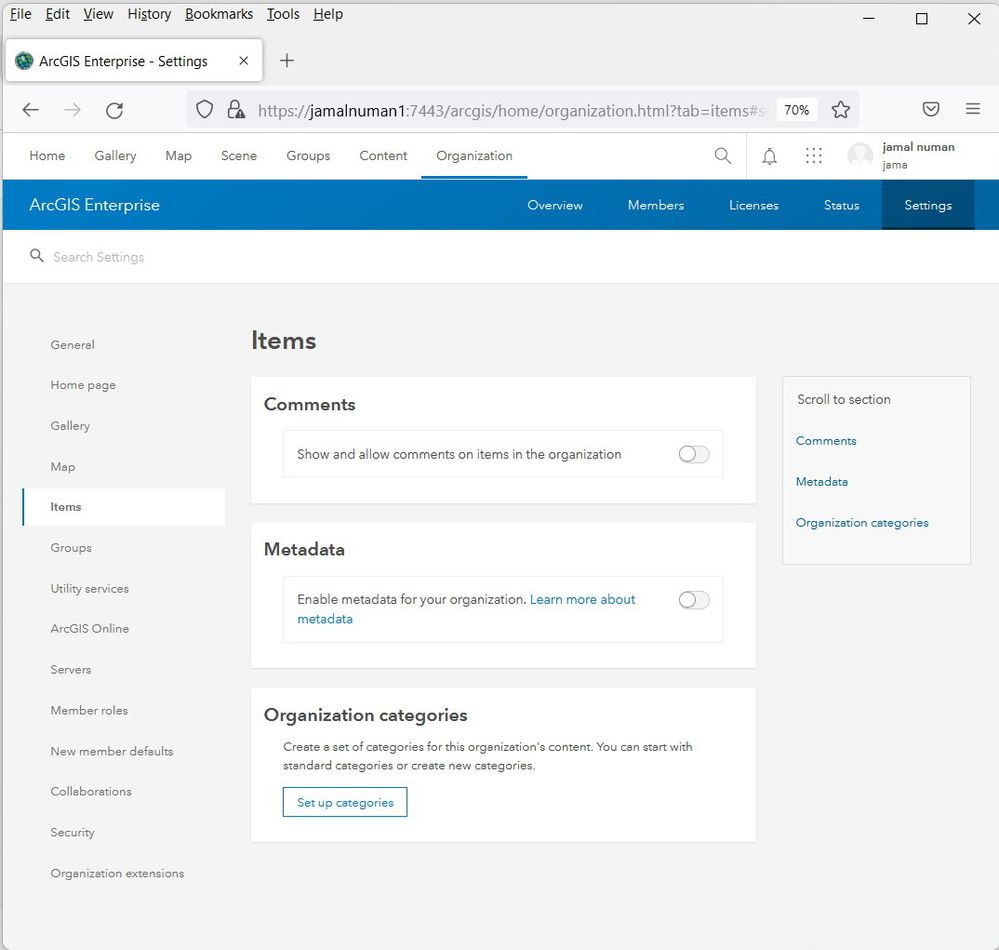

JamalNUMAN
Legendary Contributor
Not sure how can I go to “item” detail in the the screenshot below
