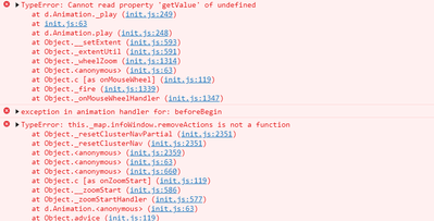

I created a dashboards and embedded an application in the dashboards. It works fine, but I am facing a strange issue, I have two screens, when I open the dashboard in the second monitor, the map in the app, which embedded in the dashboards, dose not  render  and it stuck, no move , no zoom in or out.
However in the main screen, the laptop screen, it works fine.

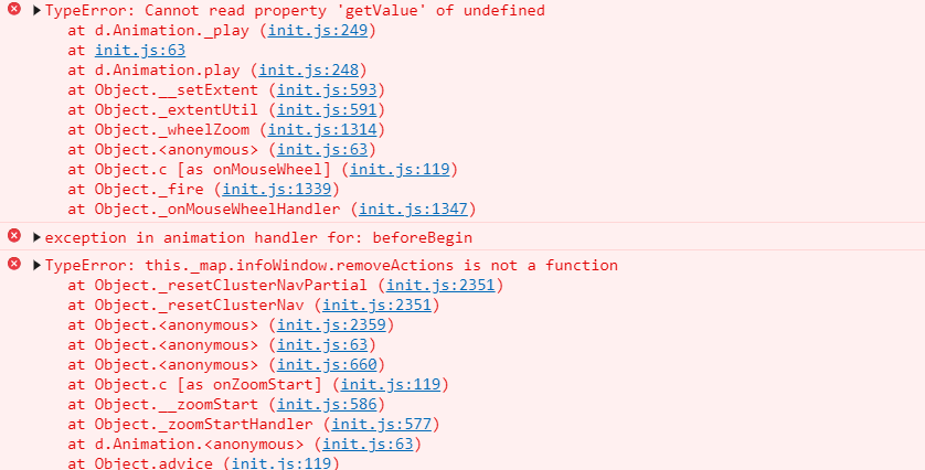

I checked the DevTool of the browser, It displays these error messages:
init.js:596 TypeError: Cannot read property 'getValue' of undefined
at d.Animation._play (init.js:249)
at init.js:63
at d.Animation.play (init.js:248)
at Object.__setExtent (init.js:593)
at Object._extentUtil (init.js:591)
at Object._wheelZoom (init.js:1314)
at Object.<anonymous> (init.js:63)
at Object.c [as onMouseWheel] (init.js:119)
at Object._fire (init.js:1339)
at Object._onMouseWheelHandler (init.js:1347)
I am  using ArcgGIS Enterprise version 10.6.1 on window server.

But there is something I noticed, if I run the application alone without embedding it in the dashboards, it works without any problem,
however that issue happens when I open the dashboard that has the application embeded in.
