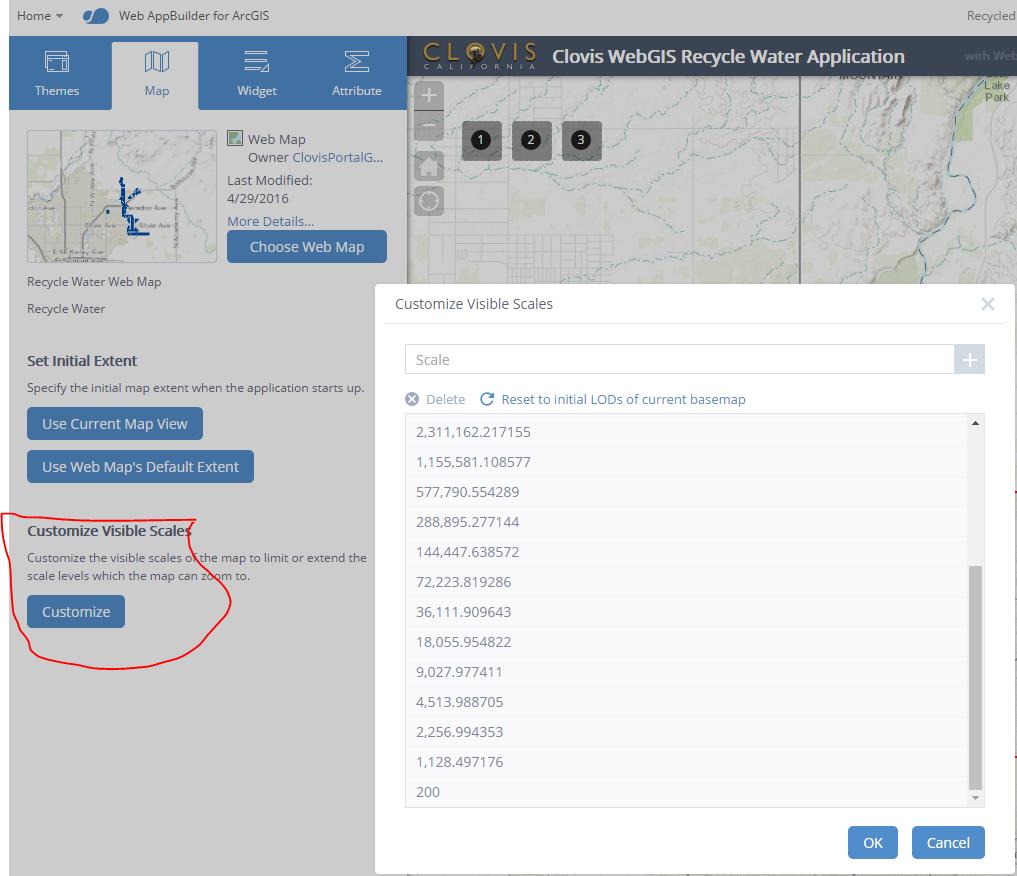

Syvertson
Very interesting.  I just checked it out and the button is grayed out.  See below:
BillFox
MVP Notable Contributor
Do the ESRI provided basemaps allow you to click that Customize button?
or at least zoom out in your basemap and select the "Use Current Map View".
