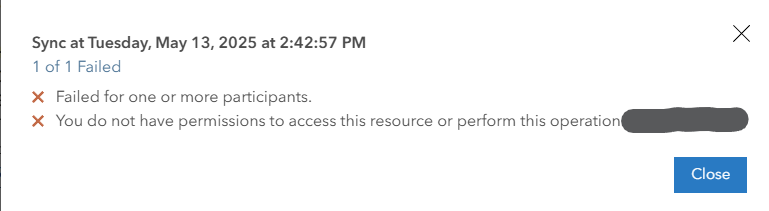

I have a Portal organization, a primary ArcGIS Online organization, and an ArcGIS Online HUB Premium organization, all of which I'm an administrator of.  There's a Partnered Collaboration between the main AGO and the HUB organization that appears to work and share access to data back and forth successfully.  We also have set up a Distributed Collaboration between our main AGO org and our Portal org that appears to work successfully.  I'm running into issues when I try and share something all the way through from the HUB site to AGO and then to the Portal and back.
In this particular case, I have a Survey123 with a hosted Feature layer in the HUB organization.  I have shared that to a partnered collaboration group and can access that from the main AGO group.  I have tested and am successfully able to see and even edit records in the hosted Feature layer from both the HUB and main AGO org.
I then created a workspace in the Portal <> main AGO org's Distributed Collaboration set to COPY with 2 way sync.  It successfully created a copy of the Feature layer hosted in the Portal.
If I make edits to features in the HUB copy of the layer from either the HUB org or the main AGO org users, I can sync the Distributed Collaboration and those edits are copied successfully into the Portal copy.
If I make any edits with any Portal users to the Portal copy though, the Distributed Collaboration fails to sync those edits through back to the HUB copy.  When I inspect the Distributed Collaboration in Portal, it shows the error:
