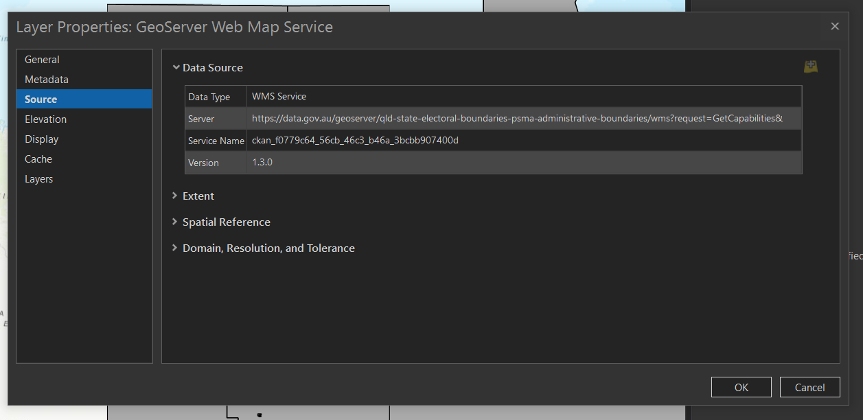

As an example I am trying to load some administrative boundaries into our hosted Portal for ArcGIS using the following link GeoServer Web Map Service but get the following message
but if I add a connection in ArcGIS Pro it works fine

I tried this on my end and didn't see any problems.  I'm using 10.5.1:
If you were to take a look at the network traffic, do you see any requests fail?  For example, when I hit the Get Layers button, a proxy request is made to the WMS service:
Ex.
https://portal.domain.com/portal/sharing/proxy?https://data.gov.au/geoserver/qld-state-electoral-bou...
Since it's a proxy request, the request is coming from the portal machine itself, not your browser.  If you were to sign onto the Portal machine as the user running the Portal for ArcGIS Window service, can you open a browser and reach the page?  If not, that would indicate that outbound requests are blocked, which is why you're seeing issues.
