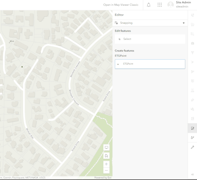

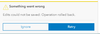

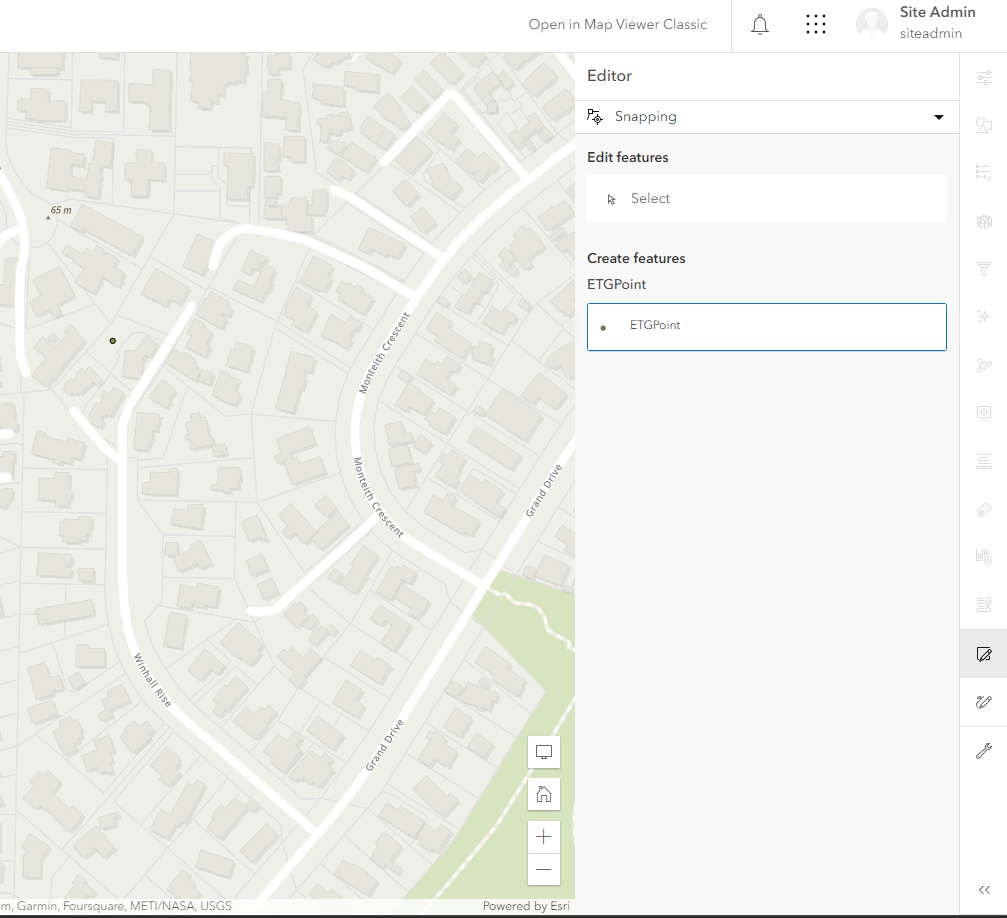

When using the Map Viewer in  ArcGIS Enterprise 11.,1 if I add a hosted feature layer and create a new feature - if I add an attachment and try to insert the feature it fails with:

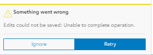

or for referenced feature layers with attachments:
The error returned by the server is
"JSONObject[\"uploadId\"] is not a string."

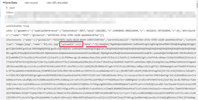

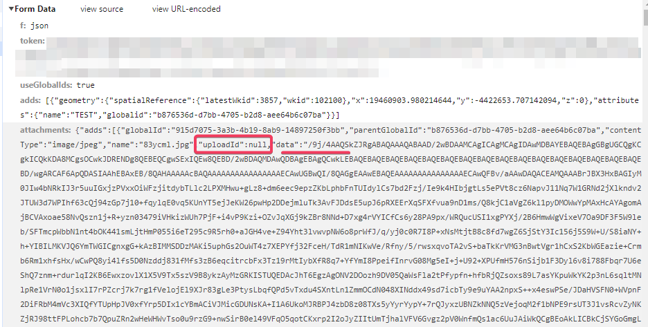

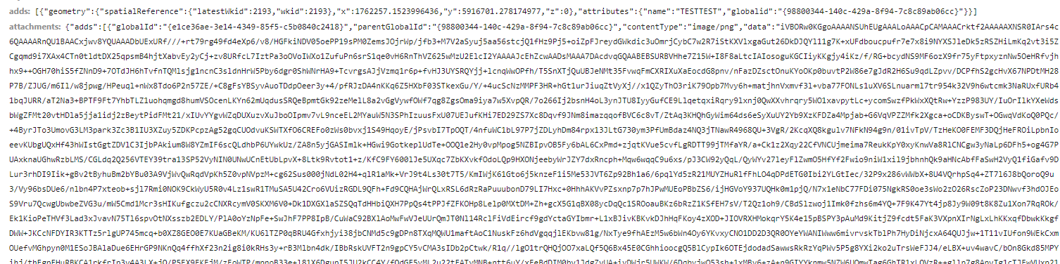

When looking at the payload for the apply edits you can see the uploadid is null, and the attachment is encoded as part of the data
So the insert fails as the uploadid isn't set.
