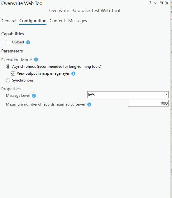

I am publishing a geoprocessing tool from ArcPro that contains arcpy.AddMessage in the original script, but when the tool is complete, the message does not show. I tried to change the properties of the message level to "Info" under the message level tab, but it still does not show up when I run the tool, as shown below.
Does AddMessage work for tools run in the Enterprise portal? If not, how will I be able to view information in the messages tab when the tool is completed?

Hello @AnjeliDubey , that Message setting looks like it should work, but we don't know how your code is written. Try something like this:
#MINIMAL SCRIPT
import arcpy
arcpy.AddMessage("Hello World !!!")
ArcGIS Pro
From Toolbox > New > Script, from Execution paste in the code. Open & Run the tool.
From View Details > Messages, you can see the Message.
From Open History, right click on the executed script > Share As > Share Web tool > Configuration tab, set Message Level = Info > Publish.
From the REST endpoint of the service > select the Task > select Submit job. From Check Job Details you will see your Hello World !!! message.
