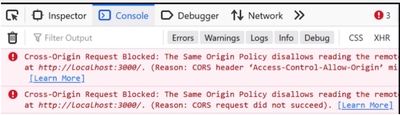

Open your browser’s developer tools (hotkey F12), reproduce the error, and check the console tab for CORS-related messages. Sample reference image below:
If you see this type of error, you'll likely need the WFS host to whitelist your domain.
