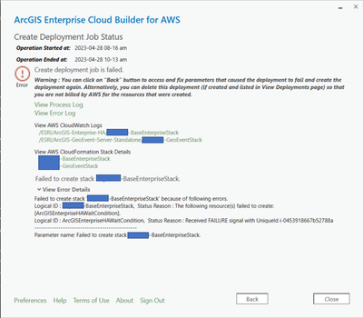

Hi,
We're using the enterprise cloud builder to deploy into AWS/Azure. Thus far, we've done single server deployments and have not encountered problems doing so.
However, we have a new requirement for a HA deployment and have encountered issues.
Currently, we have 2 main questions relating to the error encountered.
  1. As this is a HA setup in AWS, do we need 2 licenses? If so, how do we request for a prvc file with 2 licenses in MyESRI?
  2. What's the proper follow up when encountering the error cited above? We'll probably be looking at the cloudformation logs. But we're unsure if this is the anticipated follow up by cloudbuilder to remediate the issue.
ChristopherPawlyszyn
From this error message I suspect that you haven't configured your DNS CNAME record properly to point to the ALB DNS record. More information can be found here if that is the case.
-- Chris Pawlyszyn

DavidHoy
yes - the cloudformation error log is a good place to start with the trouble shooting.
All we can see from the screen shot is that there was an error after 2 hours - so that sounds like it was almost there.
regarding licenses.
If you are building an HA stack with CloudFormation you will only need one ArcGIS Server license file - if this is just a base ArcGIS Enterprise, an ArcGIS Server Standard license would be OK.
BUT, this must be a license file that covers 2 AWS Availability Zones - so that will consume 2 of your organization's Server licenses (each up to 4 Cores or 8 vCores in AWS). Speak with you License Administrator to get a license file that covers this.
BTW, even if you only have a license file for one AGS license - that wont be the cause of your CF failure.
But if you are trying to re-use a .prvc file you have already installed elsewhere, then that may well be the problem. When the Chef script within the CF template tries to authorize the ArcGIS Server site that has been created. it may be that the Esri licensing management is rejecting the file because it has already been used.

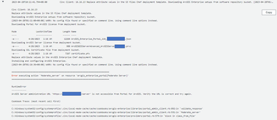

JosephSia2
The following issue observed in cloudformation logs for BaseEnterprise Stack.
-- Chris Pawlyszyn
JosephSia2
Yes. That was indeed the issue. Enterprise was successfully deployed after i sorted out the DNS configuration. Many thanks.
