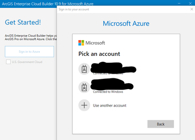

Most probably it is related with your tenant or subscription. When you click login you will see somethings like below to complete login process.

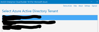

After that you should see the screen something like below to select a tenant.

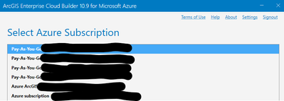

Then you click next and you will see list of subscriptions.
Make sure you have permission or any valid subscription to deploy ArcGIS Enterprise.
