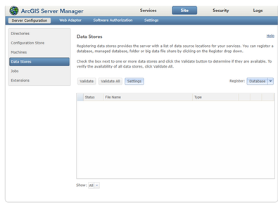

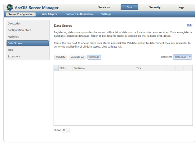

I prepare upgrade unfederated geoanalytics server site and we do not have a big data file shares set, as esri documentation recommend.
GeoAnalytics Server:
  • Big Data File Shares: Before upgrading, unregister all big data file shares from the GeoAnalytics Server site. If these were added in the portal, remove them there; if added in ArcGIS Server Manager, remove them using ArcGIS Server Manager.big data.png
  • Unfederation: Unfederate the GeoAnalytics Server site from the portal before starting the upgrade process.

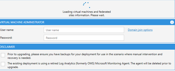

 What i understand Cloud builder for azure will delete Monitor Agent, right? (Microsoft Monitoring Agent. The agent will be deleted prior to upgrade)

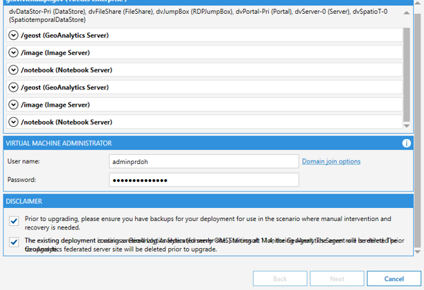

As i mention, i unfederate Geoanalytics server but Cloud Builder does not me allow to go next.
And, as you can see on the image, the geoanalytics disclaimer or error about unfederated server site before is overlapping the other disclaimer. What am i doing wrong? Do i need to remove fist the retired Log Analytics (formerly OMS) Microsoft Monitoring Agent manually first or upgrade it first?
any suggestions?
