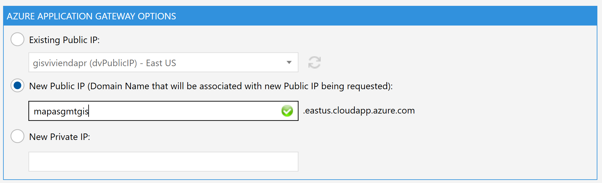

I am using this option, create a public IP for eastus.cloudapp.azure.com

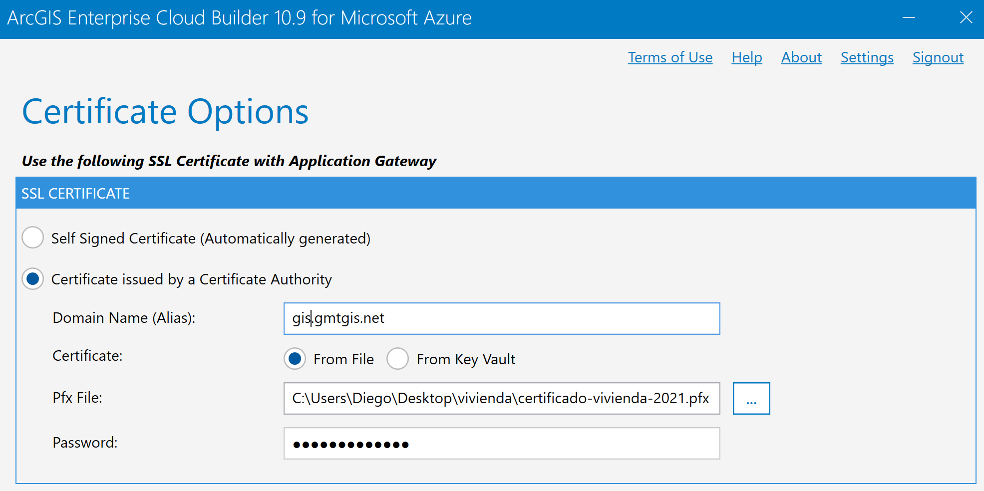

And then I am adding my wild card certification.
I open a support incident with esri but they have not been helpful. they told me that I need to use in my public IP domain name my dns from my cert (gis.gmtgis.net)  to recognize the same DNS but Azure do not allow dots in that field, it need to be no space and no dots.
So, then they told me to use self sign certificate option, but if I use that option, federation would be done with gisgmtgis.eastus.cloudapp.azure.com and not with my selected public url. gis.gmtgis.net/portal/home so I would need to change my certificate in the getway app and then unfaderate and federate again (i do  not know if this is even possible to do, that is what I am thinking to do)

What I did was before run Cloudbuilder I had to say in godaddy that my azure url needs to redirect to my public url.  So in godaddy i configure  that this url https://gisgmtgis.eastus.cloudapp.azure.com is going to redirect to https://gis.gmtgis.net   Once i ...
so you need to have what azure url are you going to use your domain name (public url) that your certificate will use and that worked for me.
