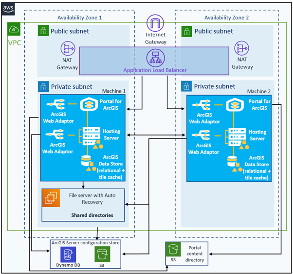

Working on a PoC to deploy ArcGIS Enterprise 11.2 base install on multi-machine (to over come the elastic IP assignment issue since our org does not use elasticIPs for security reasons).
Using @
https://arcgisstore.s3.amazonaws.com/1120/templates/arcgis-enterprise-ha.template.json
for automation deployment.

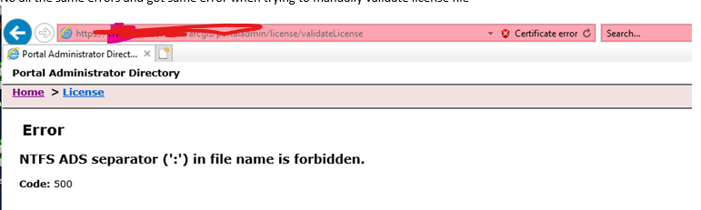

Error executing action `authorize` on resource 'arcgis_enterprise_portal[Validate Portal for ArcGIS Authorization File]'
SocketError
Failed to open TCP connection to : (getaddrinfo: No such host is known. )
