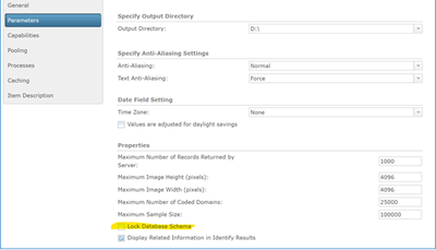

A_Wyn_Jones
This is already implemented through schema locking (disabling it) on the map service:
https://enterprise.arcgis.com/en/server/latest/administer/windows/disabling-schema-locking-on-a-map-...
It must be done while the map service isn't under load to prevent unexpected behaviour for users as the field disappears from existence mid-session 🙂 i.e. when looking at the attribute table
All fields are picked up when initialising the map service in your map viewer session.
Bud
@A_Wyn_Jones Thanks. We'd already disabled schema locking. That doesn't seem to have helped.
We don’t really understand how disabling schema locking fixes this problem.
If anything, if schema locking was turned on, we would have had to stop the service > remove the fields > restart the service. And I think the service wouldn’t have “broken” that way.
