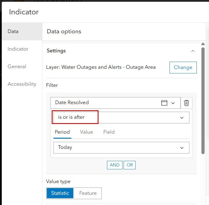

Screenshot 1: Date filter is or is after Today available in ArcGIS Dashboards. Sample Indicator widget displayed below.

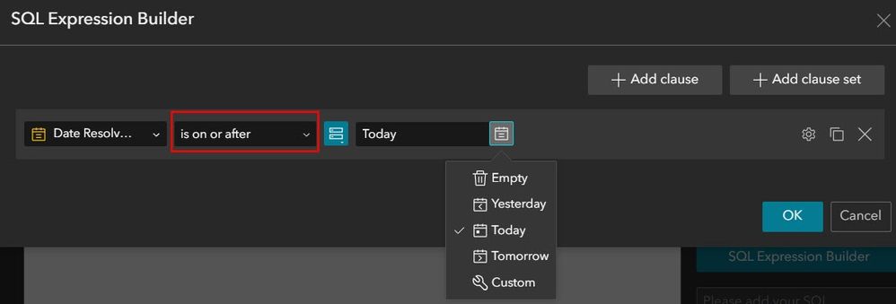

Screenshot 2: Date filter is or is after Today available in Experience Builder. Sample Filter widget displayed below.

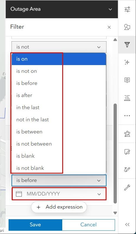

Screenshot 3: Date filter is or is after Today NOT AVAILABLE in ArcGIS Enterprise Map Viewer. Sample Filter expression does not contain this specific filter. The date parameter also requires a specific date to be entered. In other words, the filter cannot be set to a relative point in time such as TodayTomorrowYesterday, etc.

Hi David,
I appreciate the note. This may be user error on my part, but I was unable to enter a manual expression into the filter for the date field. I wonder if this works in AGOL but not in ArcGIS Enterprise.
Great idea to use a SQL or Arcade expression. When I click Add Expression in the Map Viewer filter prompt, I only have the option to use the Expression Builder. I do not see an option to switch to an expression or add a stand-alone expression as you would in the pop-up configuration in Map Viewer.
For example, another user posted about a similar issue (past instead of future dates) in the Esri Community pages: https://community.esri.com/t5/arcgis-online-questions/arcade-expression-for-date-equals-today-or-ear...
Helpful Arcade expression here if the prompt was available: credit to @DonShawEsri for this one. 🙂
