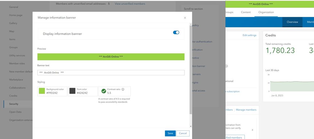

@Sarah_of_Lubbock  I have found a work around that does the job.  In ArcGIS Online, go to Organization -> Settings -> Security -> Information Banner.  You can style something here to make it obvious!

@JamiePetersen - thank you!  I added this to our environments - and it is for sure helping!  It would just be nice to have left that available as an updater or something.  But our work is so small right now - anyone that would need to know about updates is probably just me XD - but here is to growing!

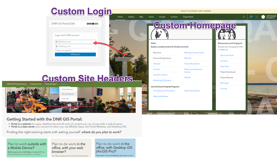

Yeah ESRI's header changes so much! It is either white (when in content), collapsed down (differently 10.9.1 in map viewer, map viewer classic or scene), cases where it could be blue.. or green as on our customized homepage...  Site headers have a different look altogether... ESRI talks about their ecosystem so much, I wish they had a more cohesive UX behind their logos... yet often you also need default admin permissions to change things... here is something that we do to our Enterprise environment... tweak the login and completely customize the homepage.  Banner, background watermarks, login text, and avoid their global navigation in sites... I want to be able to easily create a cohesive look and it is increasingly difficult to do with their new home page structure...

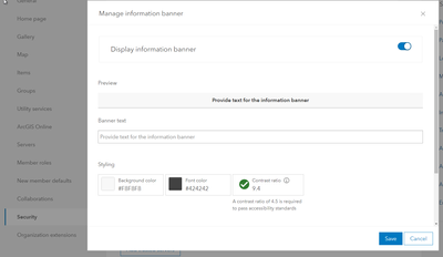

Thank you for your post! This is currently possible in Portal, similar to the workflow provided by @JamiePetersen in ArcGIS Online, by going to Security > Set Information Banner > Display Information banner > using the options to set the background and font color.
