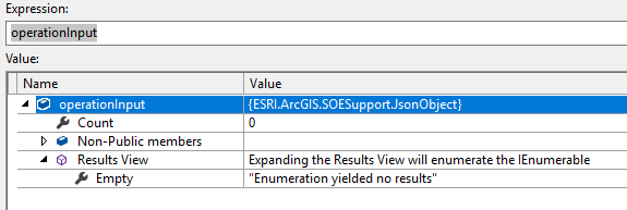

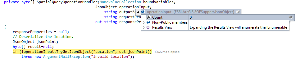

It is going to SOE but could not able to read the "Location" Parameter and its values. PFB image for the same.
Can anyone let know, how parameters need to be send?

JsonObject parm1Value;
bool found = operationInput.TryGetJsonObject("Location", out parm1Value);
if (!found)
    throw new ArgumentNullException("Location");
IPoint location = Conversion.ToGeometry(parm1Value,
        esriGeometryType.esriGeometryPoint) as IPoint;
